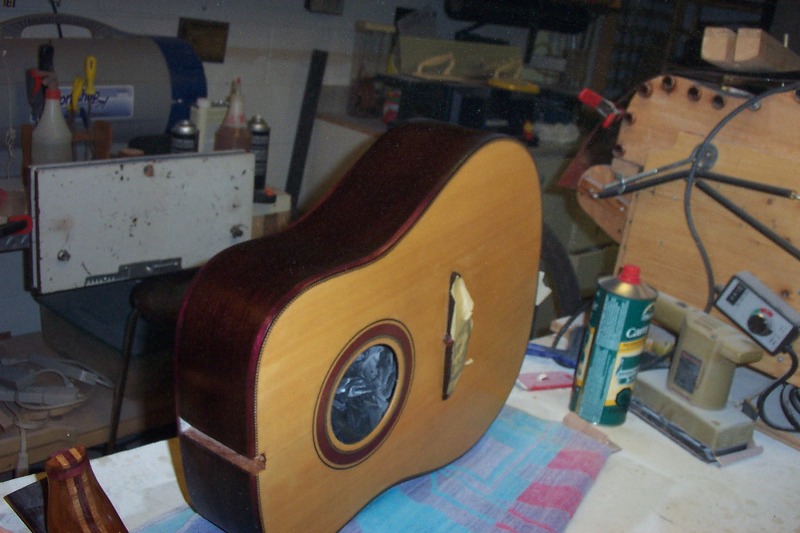

Well folks, a while back, my bud Alain taught me how to FP but as soon as as i got to be on my own to do it, i failed, i learned, with FP, that my patience level is not that high, there are things we can all do but for me, FP ain't one or maybe i should say that finishing is one of those steps where i feel i have not what it takes, maybe with time but right now, i'm just hoping for a miracle....
So before i put my fist through my Mom's guitar, i decided to abandon FP in favor of spray cans of Varathane over a seal coat of shellac, i have dsprayed 7 layers on the top and also 7 on the neck and here how it looks so far...
i really think that if i'm ever make a living at this, that i'll be farming out the finish unless someone has a miracle product for someone like me
Thanks for lookin'!

Unfortunately Serge, the only surefire miracle product is hard work. I've heard many builders say that the finish does and should take about the same amount of time to do as the entire rest of the build. There are no short cuts when it comes to getting a good finish. It's all practice and lots of patience.
It's hard I know cause you've just spent the last 3-6 months or more building this guitar and you just want to get it done, but in reality you have many many more hours to go to get it looking as good as it can.
Hang in there bud, this is only your second project. I refinished my third one 3 times (striped it down to bare wood every time) and I'm still not thrilled with it. The 4th turned out better, but I was much more patient etc..... Don't give up on the FP, get Robbies DVD maybe, get together with Alan some more, his turned out very nice from the pics he posted. You can do it.
Remember, this hobby is building even more character for you my passionate friend. Finish is something that you have to become one with the universe with (think of the lowly monks high in the Andes, sitting and meditating all day long, you know the ones we see in the movies and TV adds of old). That is kind of the mindset required for finishing. Take lots of deep breaths (just make sure your wearing a respirator mask ) and eventually, you will get it. I bet there isn't one builder out there that would like to redo the first 5-10 finishes they did themselves after they finaly "got" it.Rod True38984.9152546296

Don't rush the varatane either Serge. I know you want to get this thing done, but you really have to wait for a good cure to start the leveling otherwise it will not turn out. It will smear the finish and you will get frustrated and will want to introduce your fist to the guitar again.
As far as I know the only two "instant" finishes for guitars are FP (which still takes cure time right) and polyester, which is very very stinky, highly toxic and highly explosive so you don't want to be doing polyester if you don't have the proper set up. Heck, the best finisher's out there would probably like minimum of one week for off gassing prior to leveling, that's the beauty of FP, your leveling as you build the layers.
I would give FP more than one more chance, especially if you have Alain willing to help you out with it. Don't rush it and it will come. As JJ said, work on a small part of the back till you have it perfect. You can always take the shellac off with alcohol right, no need to sand anything down. Just lots of rags.
You will get it, I'm sure of it.
If you turn to spray lacquer, be prepared to wait at least 3 weeks after the build coats (10-12) before you can start to level it, than a couple more top coats, wait some more for final leveling, and the polishing stages. It's a long process.
Remember that shellac and lacquer are evaporative finishes and can be "reworked" if you sand through, you can just add some more to the localized area and the new finish will burn into the existing and all will be one.
Varnishes and polyurethanes like your varathane are reactive type finishes which means that once one coat cures, the next coats sit on top but don't become one with the last coat, they bond together but don't burn into one another. This will cause witness lines if you sand to much in one area when leveling.
There are pro's and con's to every type of finish, you just have to decide which one you want to try, try it out and see how it goes. They can all come off at worst and you can always try again.
The scrap board finishing is always the best idea, but not always the most fun right .

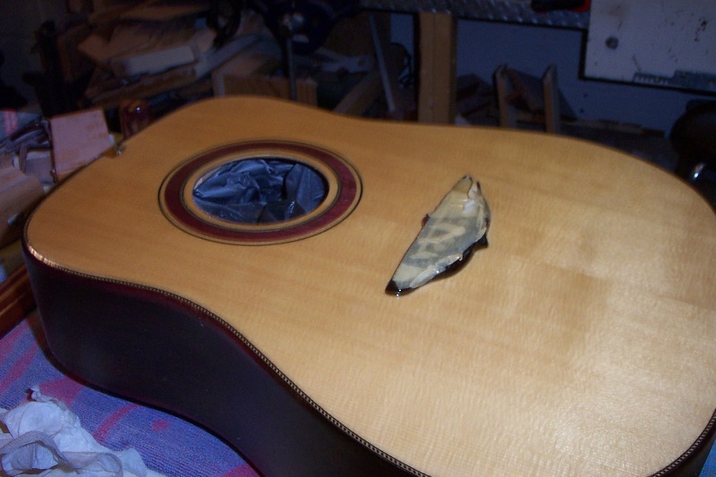

I sure will keep the chin up as everyone advises me to, so far, i have 8 or nine layers of Varathane on the top and neck, i layer on the back and one on one of the sides, the nice thing about this product is that each layer kind of melts into the previous one so i should be all right, although , like Alain mentions, i probably should sand level which i did not do yet!
But at this point, i'm not going to go for perfection, i already accepted that it will be a learning curve with flaws. Not sure if FP will still be in my vocabulary after Alain builds his spray booth though, i'd rather spray than polish from what i know so far!

Hang in there Serge. One of the best finishes I ever did was with Varathane. The manufacturer says you can't spray it. (unless you have the spray version of the product) and that it can't be buffed to a high gloss. Well, I did both, and like I said, It was one of the best finishes I ever did. It smelled like an oil varnish for a few weeks.

There is no set rule for cure times. It depends on weather conditions, thickness of coats etc. You need to find what works for you in your area. The floor urethanes such as the product varathane are quick drying products and usually you can put furniture back in a room after 24 hours and have heavy traffic after 48 to 72 hours. I wouldn't recommend putting furniture or having heavy traffic on your guitar however!
I would give it a few days and try and wet sand it and buff it. If you notice some problems give it a few more days and try again. With that said, the more cured it is the better so if not in a hurry, take your time and let it cure for a couple of weeks.
